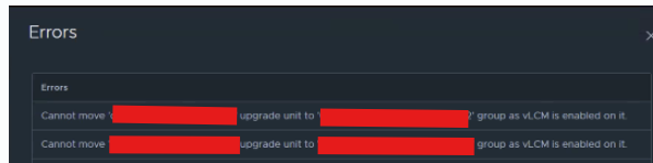

Running the upgrade precheck displays the following error: Cannot move '<Hostname>' upgrade unit to '<group_nam>' group as vLCM is enabled on it.

  • You see the following error when running the Upgrade precheck:
    "Cannot move '<Hostname>' upgrade unit to '<group_name>' group as vLCM is enabled on it"
