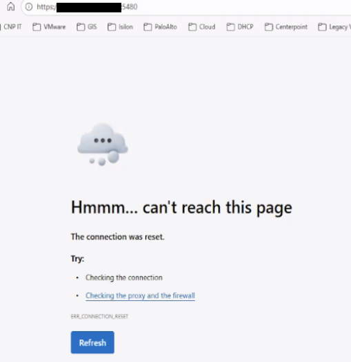

  • Connectivity to the VAMI is currently unavailable.
  • Attempts to access the VAMI result in a “connection was reset” error in the browser on port 5480, and SSH access on port 22 fails with ssh_exchange_identification: read: Connection reset by peer.
  • Despite these management access issues, vCenter and vSphere replication services remain functional and accessible within the local network segment.
  • The output of the connectivity test, from the client system, using CURL over port 5480 & 22 shows unsuccessful connection.

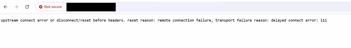

For vSphere replication:

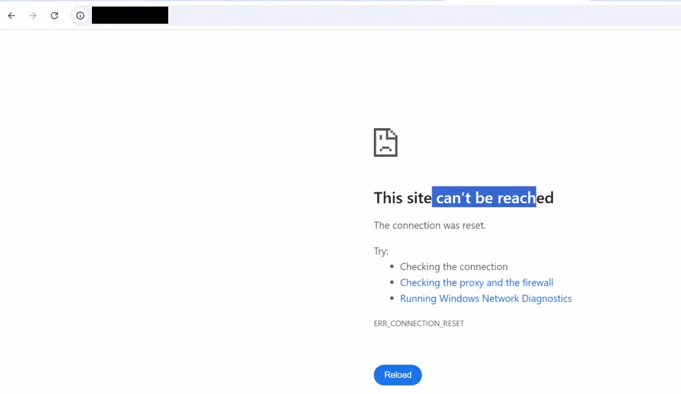

  • Error Messages Observed: Initial browser attempts threw an Envoy proxy routing drop: "upstream connect error or disconnect/reset before headers... delayed connect error: 111". Subsequent service manipulations resulted in an HTTP 404 Not Found page or an abrupt ERR_CONNECTION_RESET block when attempting to navigate to port 5480.
