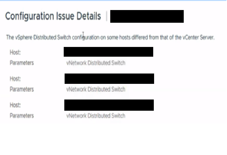

The vSphere Distributed Switch configuration on some hosts differed from that of the vCenter server/var/log/vmware/vpxd/vpxd.log has the error, "Unable to set DVS vendor data com.vmware.nsx.ens.loadbal" for the problematic ESXi host after its reboot during host configuration YYYY-MM-DDTDD:MM:SSS.ABCZ info vpxd[05890] [Originator@6876 sub=vmomi.soapStub[821]] SOAP request returned HTTP failure; <<io_obj p:0x################, h:566, <UNIX ''>, <UNIX '/var/run/envoy-hgw/hgw-pipe'>>, /hgw/host-yyyyy/vpxa>, method: invokeHostTransactionCall; code: 500(Internal Server Error); fault: (vim.fault.DvsApplyOperationFault) {--> faultCause = (vmodl.MethodFault) null,--> faultMessage = <unset>,--> objectFault = (vim.fault.DvsApplyOperationFault.FaultOnObject) [--> (vim.fault.DvsApplyOperationFault.FaultOnObject) {--> objectId = "## ## ## ## ## ## ## ## ## ## ## ## ## ## ## ##",--> type = "vim.DistributedVirtualSwitch",--> fault = (vim.fault.PlatformConfigFault) {--> faultCause = (vmodl.MethodFault) null,--> faultMessage = (vmodl.LocalizableMessage) [--> (vmodl.LocalizableMessage) {--> key = "com.vmware.esx.hostctl.default",--> arg = (vmodl.KeyAnyValue) [--> (vmodl.KeyAnyValue) {--> key = "reason",--> value = "Unable to set DVS vendor data com.vmware.nsx.ens.loadbal: Status(bad0007)= Bad parameter"--> }--> ],--> message = "Operation failed, diagnostics report: Unable to set DVS vendor data com.vmware.nsx.ens.loadbal: Status(bad0007)= Bad parameter"--> }--> ],--> text = ""--> msg = "An error occurred during host configuration: ."
