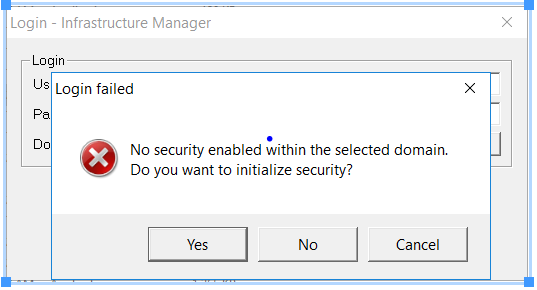

NOTE: The next two sections ONLY apply if you used the MOVE option above.
       e) Log into IM and it will prompt you to initialize security, then select Yes.
Initialize Security (Initialize Security = same as ("Remove the security.cfg then try to log in with IM and you will be prompted to set an administrator password")
       f) Enter a NEW password for the NimBUS (UIM) administrator and click Ok.
Do NOT login IF the IM client 'prompts' you...just move on to perform the next step below...
