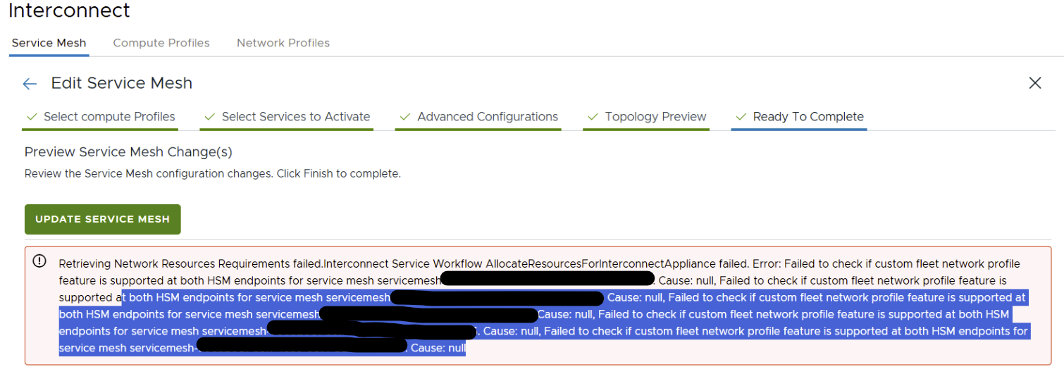

  • VMware HCX. When updating or creating a Service Mesh, the process fails at the resource allocation phase.
  • Symptoms:
    • Error: Retrieving Network Resources Requirements failed.Interconnect Service Workflow AllocateResourcesForInterconnectAppliance failed.
    • Error: Failed to check if custom fleet network profile feature is supported at both HSM endpoints for service mesh-UUID Cause: null
    • Retrieving Network Resources Requirements failed.Interconnect Service Workflow AllocateResourcesForInterconnectAppliance failed. Error: Failed to check if custom fleet network profile feature is supported at both HSM endpoints for service mesh servicemesh-################. Cause: null, Failed to check if custom fleet network profile feature is supported at both HSM endpoints for service mesh servicemesh-################. Cause: null
    • Site Pairing is successful, but Interconnect appliances fail to deploy.
