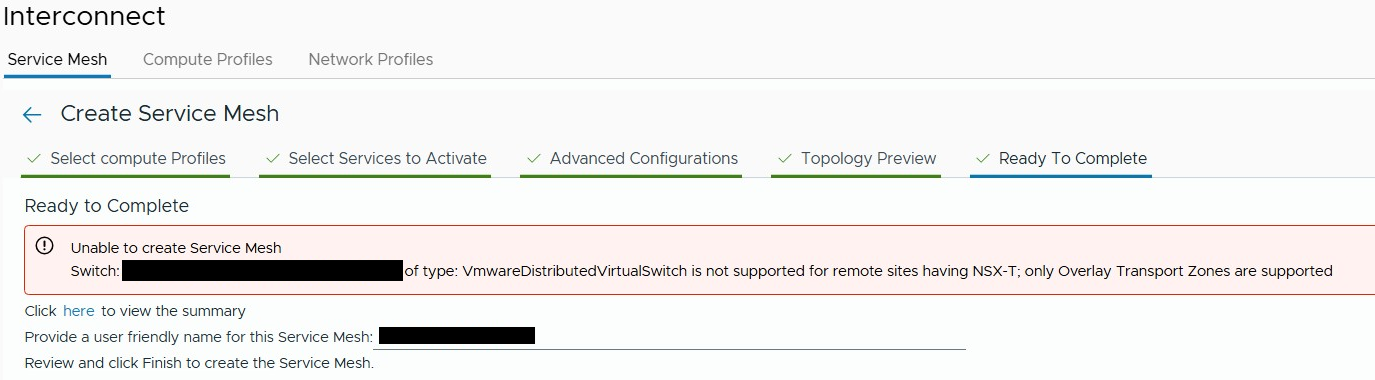

  • When creating an HCX service mesh, an error similar to the following is generated:
    Unable to create Service Mesh
    Switch: ###### of type: VmwareDistributedVirtualSwitch is not supported for remote sites having NSX-T; only Overlay Transport Zones are supported.

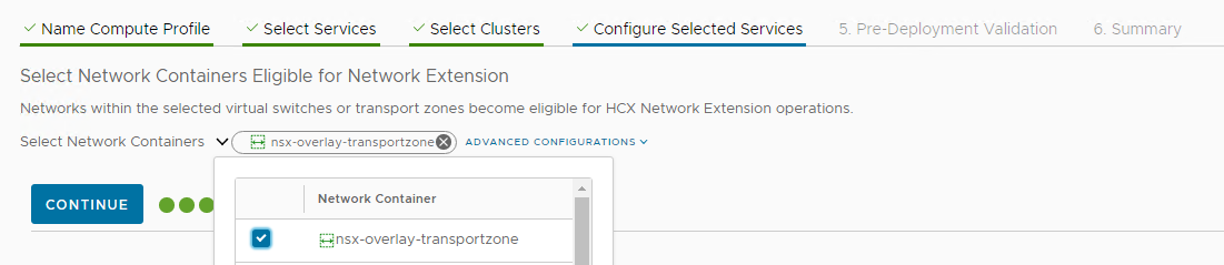

NSX overlay transport zone must be configured at the destination site and the compute/network profiles be updated to use the appropriate NSX-backed segment:
  • Update the Compute Profile, and under the step "Select Network Containers Eligible for Network Extension" change from the DVS switch to use an overlay transport zone:

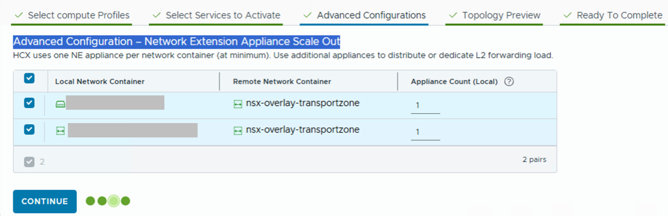

  • At the "Advanced Configuration – Network Extension Appliance Scale Out" step, make sure that only overlay transport zone is selected for "Remote Network Container" as vDS is not supported:
  • Continue with the configuration of the Service Mesh and complete it then.
