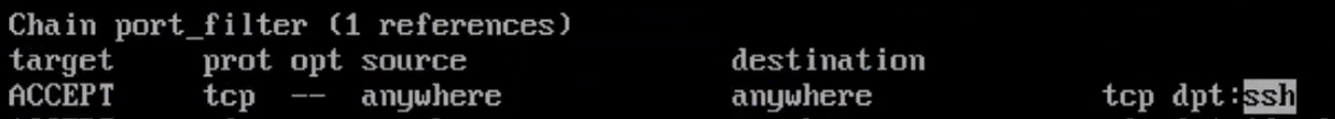

  • You've already validated the vCenter firewall and there are no blocks for ssh port
  • SSH access to the vCenter server is successful when initiated from a VM on the same subnet.

  • Confirm Service Status: Ensure the SSH service is enabled and the vCenter firewall is not configured to drop local traffic.
