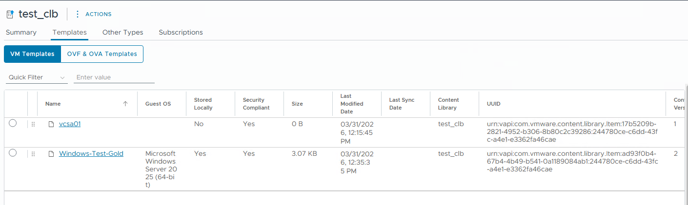

  3. If the option is greyed out or the entry persists in the Content Library UI, then take note of the UUID of the stale Template from the list.
    For Example, Windows-Test-Gold is unable to be removed:

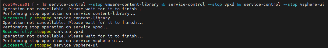

  1.  Log into the vCenter via an SSH session (How to enable SSH service on vCenter Server Appliance) and stop the Content Library, vCenter Server (vpxd and UI) services with the following command:
    service-control --stop vmware-content-library && service-control --stop vpxd && service-control --stop vsphere-ui

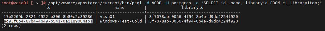

  2. Using the following command, make sure the UUID matches what we saw in the vCenter UI and record the UUID:
    /opt/vmware/vpostgres/current/bin/psql -d VCDB -U postgres -c "SELECT id, name, libraryid FROM cl_libraryitem;"
  3. Delete the stale template with the following command, be sure to replace YOUR_ITEM_ID with the correct id, if successful the line will return as "DELETE 1":
    /opt/vmware/vpostgres/current/bin/psql -d VCDB -U postgres -c "DELETE FROM cl_libraryitem WHERE id = 'YOUR_ITEM_UUID';"

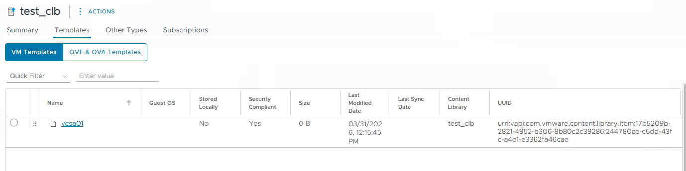

  4. List the templates again to confirm removal:

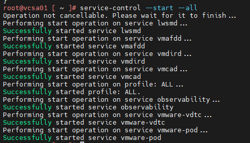

  5. Restart the vCenter services with the following command:
    service-control --start --all
  6. Log back into the vCenter UI and confirm that the template has been removed.
