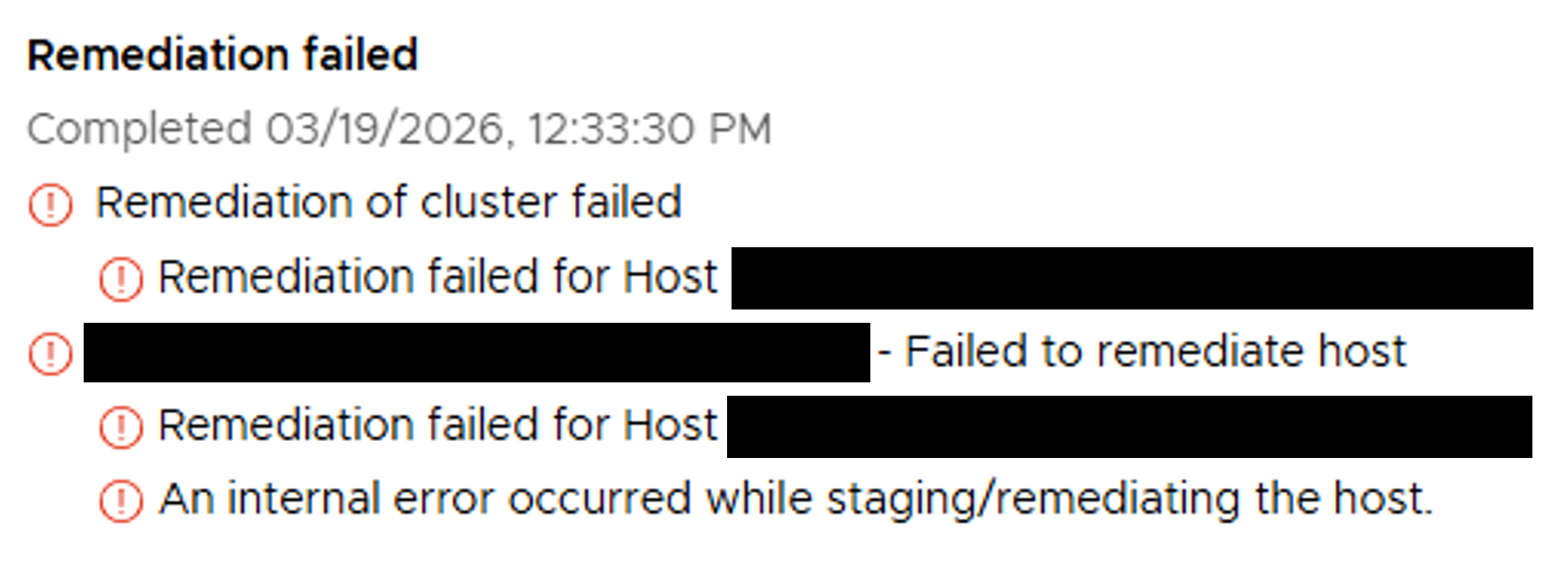

When performing host remediation or image updates via vSphere Lifecycle Manager (vLCM), the task fails during the execution of Python scripts. This often occurs during the stagebootbank mounting phase or when applying specific VIB components.
The Remediation task fails with the following errors:
Remediation failed:
Completed <date>, <time>
Remediation of cluster failed
Remediation failed for hosts <hostname>
<host-name> - Failed to remediate host
Remediation failed for host <hostname>
An internal error occurred while staging/remediating the host.
