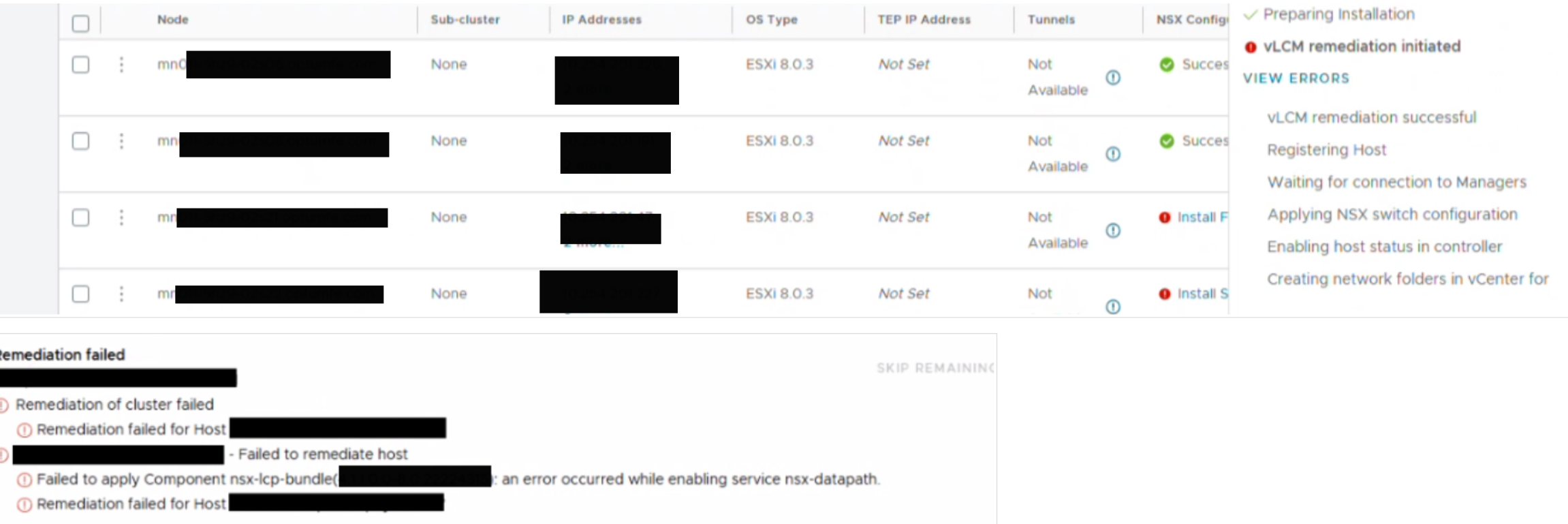

When attempting to upgrade NSX on a vSphere Lifecycle Manager (vLCM) enabled cluster, the remediation process fails during the installation of VIBs. The following symptoms are observed:
  • NSX deployment or upgrade status shows as failed in SDDC Manager or NSX Manager.
  • The vLCM remediation task terminates unexpectedly with Install Failed
Remediation Failed
Remediation of cluster failed
Remediation failed for Host ###
Failed to remediate host [REDACTED]
Failed to apply Component nsx-lcp-bundle[REDACTED]: an error occurred while enabling service nsx-datapath
