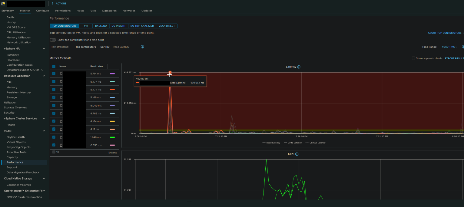

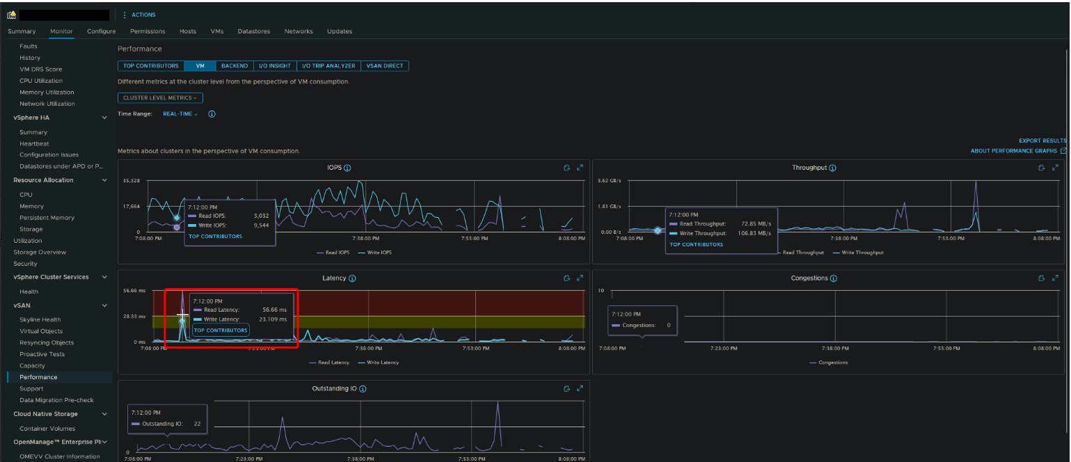

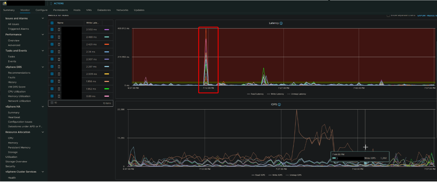

From vSAN Perf Graphs via vCenter > vSAN Cluster > Monitor > vSAN > Performance you observe the following:
Note: The preceding Perf Graphs excerpts are only examples. Date, time, and environmental variables may vary depending on your environment.
