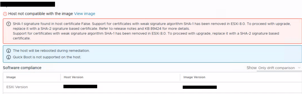

  • During the ESXi 8.0 patching process, the pre-check fails and displays the following error string: SHA-1 signature found in host certificate False. Support for certificates with weak signature algorithm SHA-1 has been removed in ESXi 8.0. To proceed with upgrade, replace it with a SHA-2 signature based certificate. Refer to release notes and KB 89424 for more details.
  • vCenter Server and the connected ESXi hosts are not using certificates with a weak digital signature algorithm. Running the vsphere8_upgrade_certificate_checks.py script (from KB 313460) verifies this configuration and detects no certificates with a SHA-1 signature. Additionally, renewing and refreshing the ESXi certificates do not resolve the error.
