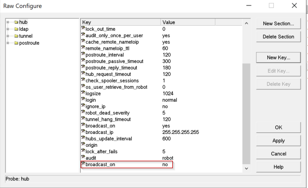

However, in some cases, business needs may require that the domain name be kept. In such cases, it is possible to have multiple, separate environments with the same domain name as long as care is taken to ensure they do not communicate unexpectedly. Specifically, in order to use the same DX UIM domain on two different installations, it is important to ensure the two instances do not communicate via UDP broadcast, so that hubs and robots do not "jump" environments.

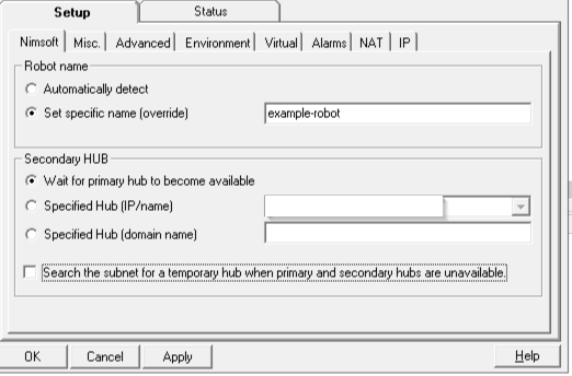

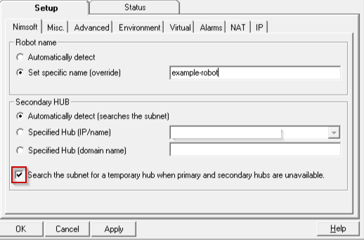

Hubs try to locate other hubs in the same domain by sending a UDP broadcast to 255.255.255.255 and robots will do the same in order to find other hubs if their assigned hub is unavailable. Both must be disabled to avoid "mixing" the domains.

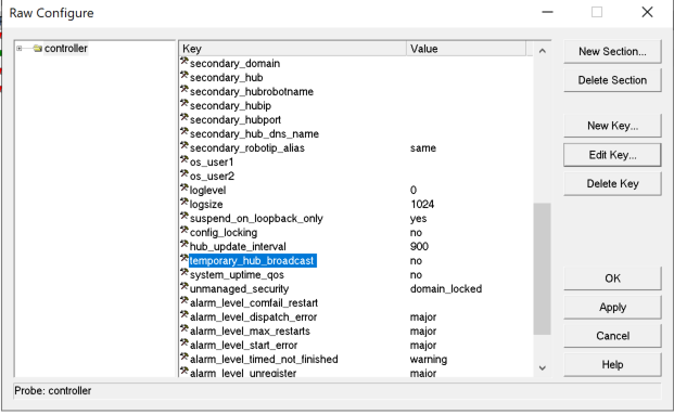

Otherwise, if UDP broadcasts are enabled in your environment, or you are not sure, follow the below steps to disable this behavior from within DX UIM itself.
Before deploying the new environment with the same domain, you must prepare the old environment by disabling all the broadcast behavior.
After you have completed this on all hubs and robots in the old environment, go ahead and set up the new environment.
