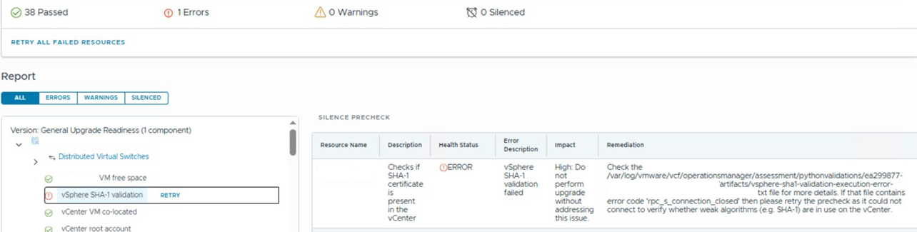

  • SDDC vCenter 8.0 patch fails precheck on vSphere SHA-1 validation. The SDDC Manager precheck reports the following error message:
    "vSphere SHA-1 validation. Support for certificates with weak signature algorithms has been removed in vSphere 8.0. Weak signature algorithm certificates must be replaced before upgrade."

An ESXi host that was previously removed from SDDC Manager was not properly removed from the vCenter Server inventory. This orphaned host retains a legacy certificate utilizing the deprecated SHA-1 signature algorithm. vSphere 8.0 strictly enforces security standards that prohibit weak signature algorithms. The presence of this non-compliant certificate in the vCenter inventory triggers the validation failure during the SDDC Manager precheck.
or
An ESXi host is currently down on the vCenter (due to hardware issues/ready for decommission) and SDDC Manager is unable to perform a vSphere SHA-1 validation on this ESXi host.
