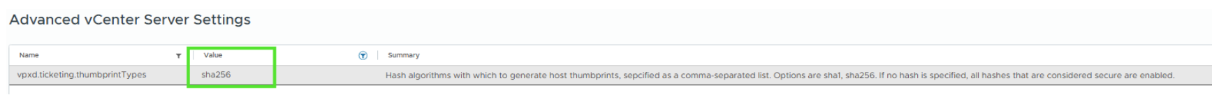

  1. In the vCenter Server go to "Configure" tab and select the "Advanced Settings". Click on the Filter Symbol next to "Name" and search for "vpxd.ticketing.thumbprintTypes" and "Config.HostAgent.ticketing.thumbprintTypes".
  2. If the value shows "sha1", change it to "sha256".
  3. If this does not fix the issue, please proceed with next steps.
