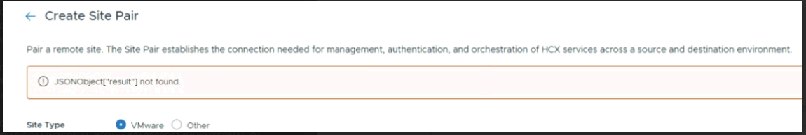

HCX Site pairing creation fails with error: JSONObject["result"] not found.

  • Creating the Site pairing  fails with the error:
