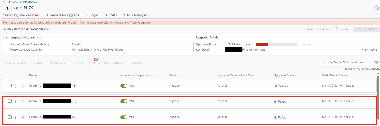

NSX host upgrade from version 4.1.2.5 to 4.2.1.4 fails as seen from NSX UI Upgrade page.
Failed error as seen from NSX UI :
ESX host 1 :
Unexpected error while upgrading upgrade unit: TX ABORT | Snapshot Time = Token(epoch=232, sequence=6335283738) | Failed Transaction ID = 9754####-d7##-####-32##-78ed####d5d4 | Offending Address = -1 | Conflict Key = 00 | Conflict Stream = 9c5a####-94##-3f##-ad##-cfc2####4151 | Cause = TRIM | Time = 62 ms | Message = Trimmed address 6335283737 has been evicted from MVOCache. StreamAddressSpace: [6335049848, 6335283783]@6335049792 size 1286.
ESX host 2 :
Unexpected error while upgrading upgrade unit: TX ABORT | Snapshot Time = Token(epoch=232, sequence=6335283738) | Failed Transaction ID = 82f6####-85##-31##-3a##-a200####efbc | Offending Address = -1 | Conflict Key = 00 | Conflict Stream = 9c5a####-94##-3f##-ad##-cfc2####4151 | Cause = TRIM | Time = 66 ms | Message = Trimmed address 6335283737 has been evicted from MVOCache. StreamAddressSpace: [6335049848, 6335283783]@6335049792 size 1286.
