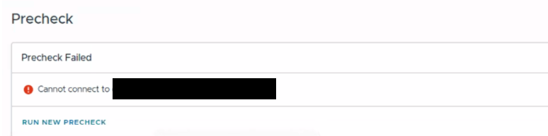

  • If an upgrade readiness pre-check is performed from SDDC, it will fail with: Cannot connect to <NSX_Manager>
