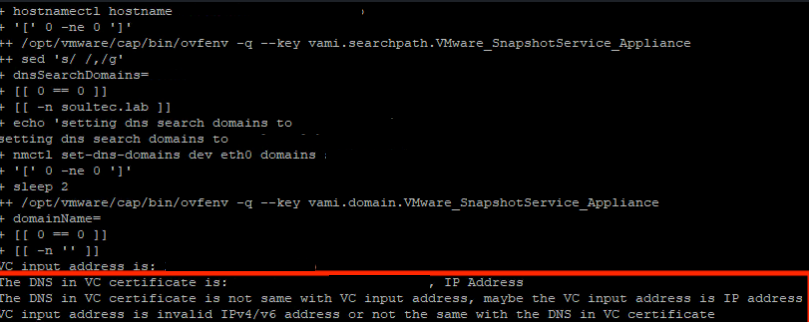

The issue occurs when the vCenter FQDN configured during the Snapshot Service Appliance deployment does not resolve correctly from the appliance. In the Snapshot Service Appliance.
In /var/log/fistboot.log below error will be seen.

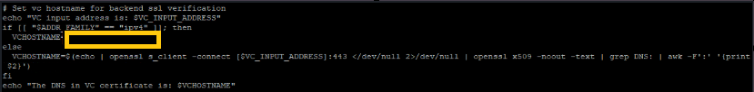

  2. Edit the firstboot configuration script:
    vi /etc/vmware/cap/cap-firstboot.sh
  3. Locate the line containing VCHostname.
  4. Remove any incorrect entries next to VCHostname.
  5. Replace it with the correct vCenter FQDN in the following format
    6.  chmod +x /etc/vmware/cap/cap-firstboot.sh --> to make the script executable
    7. sudo /etc/vmware/cap/cap-firstboot.sh --> run the script
