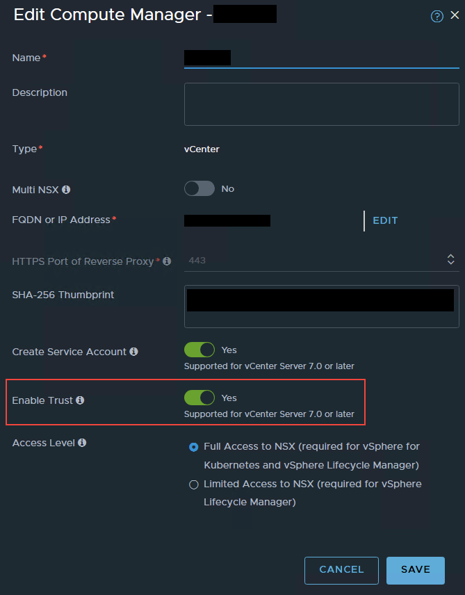

The WCP service startup failure on vCenter caused the maintenance mode task to fail.
The wcp service is in a stopped state because the NSX Manager is unable to establish a trust with vCenter due to a thumbprint mismatch.
