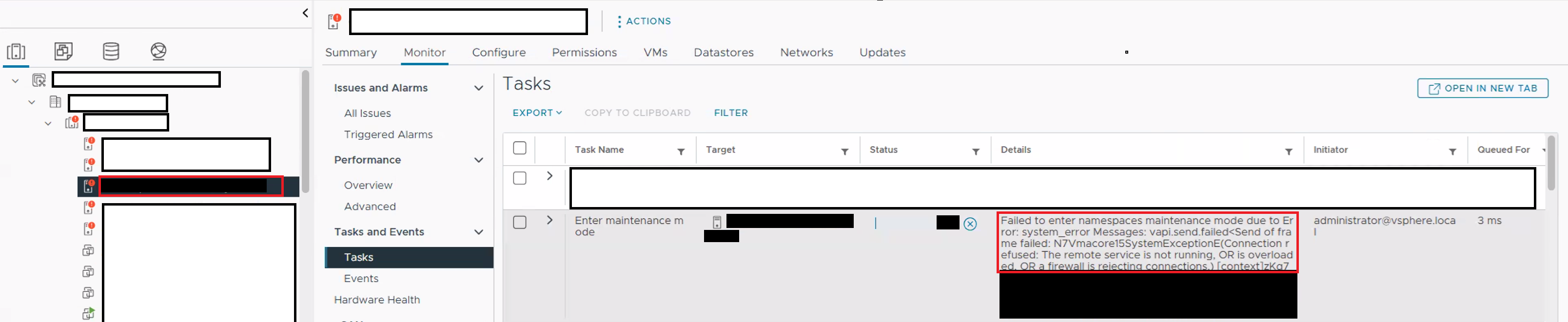

You experience one or more of the following symptoms:
  • When attempting to put a vSAN Host in Maintenance Mode you are observing the error:
"Failed to enter namespaces maintenance mode due to Error: .... The remote service is not running, OR is overloaded, OR a firewall is rejecting connections ...."
  • The operation to place an ESXi host into maintenance mode from vCenter UI may generate the following error message: "The operation is not allowed in the current state. Host name cannot enter maintenance mode due to host latch failure."
  • The NSX Manager upgrade, initiated from the SDDC Manager, stalled because the 'Enter maintenance mode' task (initiated by com.vmware.nsx.management.nsxt) remained stuck at 0% in vCenter.
  • Below error was observed in vCenter:
