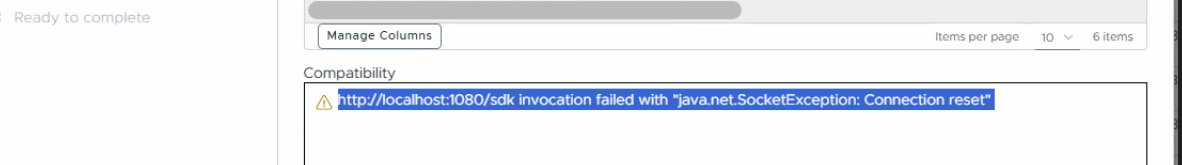

  • During the deployment of a new virtual machine, datastore validation fails and displays the following compatibility warning:
    "http://localhost:1080/sdk invocation failed with "java.net.SocketException: Connection reset"
