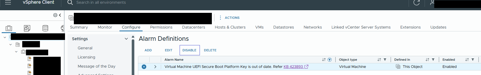

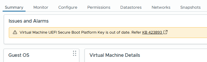

  • vCenter Alarms:
    • After both VC and ESX update to 9.1.1.0, vCenter shows the alarm "Virtual Machine UEFI Secure Boot Platform Key is out of date. Refer KB 423893" at VM level and aggregated alarm at Cluster level. This alarm indicates that the virtual machine's UEFI Secure Boot Platform Key (PK) is out of date and needs to be updated.

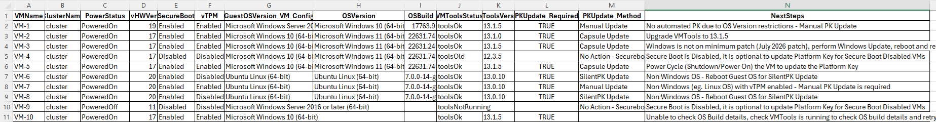

      1. Identify the Virtual Machines with Secure Boot & vTPM Enabled (PowerShell option available to list the VMs).
        1. For ESX 9.1.1.0, follow Identify the Virtual Machines with Secure Boot & vTPM Enabled in VMware ESX 9.1.1.0.
    PowerShell method to list the Secure boot and vTPM status.
    1. Open PowerShell as Administrator
    2. Login to vCenter Server using Connect-VIServer
      Connect-VIServer -Server <vc_fqdn / ip_address> -User <username>
    3. Execute below CmdLet to identify the list of VMs with Secure boot enabled
      Get-VM | Where-Object {$_.ExtensionData.Config.BootOptions.EfiSecureBootEnabled -eq $true} | Select Name
    4. Execute below CmdLet to identify the list of VMs with vTPM enabled
      Get-VM | Where-Object { $_.ExtensionData.Config.Hardware.Device | Where-Object { $_.GetType().Name -eq "VirtualTPM" } }
    Note: Sample PowerShell script “SecureBootExportVMList.ps1” attached to this KB can be used to export all the VMs list from a vCenter Server in a CSV format as below:
    To identify VMs that are configured with out-of-date NULL PK, you can monitor the 'Virtual Machine UEFI Secure Boot Platform Key is out of date' alarm directly within the vCenter UI, or execute a PowerCLI script across your upgraded vCenter Server and ESX hosts to generate a detailed inventory of impacted VMs that have out-of-date NULL PK.
      Connect-VIServer -Server <vc fqdn / ip address> -User <username>
      Note: Sample PowerShell script “SecureBootExportVMListv2.ps1” attached to this KB can be used to export all the VMs list from a vCenter in a CSV format as below:

    Managing vCenter Alarms
    Post VC and ESX update to 9.1.1.0, you may see "Virtual Machine UEFI Secure Boot Platform Key is out of date" alarms for individual VMs where Platform Key needs an update:
    Bulk Acknowledgement Procedure via UI
    1. Select the vCenter object and navigate to the Monitor tab.
    2. Go to Issues and Alarms > Triggered Alarms.
    3. Filter the "Secure Boot" alarms.
    4. Select all relevant VM alarms and click Acknowledge.

    Disable Alarm (in case Secure boot alarm needs to be disabled)
    1. Select the vCenter object and navigate to the Configure tab.
    2. Go to Alarm Definitions
    3. Filter the "Secure Boot" alarm definition.
    4. Select the alarm and click on Disable..

Q: How can I identify VMs that are lacking the Windows OEM Devices PK certificate?
  • Refer to Identify the Virtual Machines with missing or NULL Platform Key.
  • You will be able to easily identify VMs lacking the Windows OEM Devices PK certificate across your environment at scale using one of the following upcoming methods:
    • vCenter Alarms: Using the "Out-of-date Platform Key Alarm" feature in VMware ESX 9.1.1.0 and planned for an upcoming release of vSphere 8 (requires patching both vCenter and ESX).
    • PowerCLI Script: Once ESX is patched (even without patching vCenter), a VMware-provided PowerCLI sample script can be used to inventory VMs lacking the Windows OEM Devices PK certificate.
