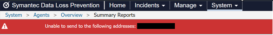

When attempting to send an email, such as a report, from the Enforce server through an SMTP server that requires TLS it fails with the "Unable to send to the following addresses" error message:
The localhost log may report the below, or similar error/s:
19 Dec 2025 10:00:03,298- Thread: 101 SEVERE [com.vontu.enforce.mail.MailClient] 530 5.7.0 Must issue a STARTTLS command first
19 Dec 2025 10:00:03,298- Thread: 101 SEVERE [com.vontu.enforce.mail.MailClient] 503 5.7.0 encryption too weak 0 less than 128
16.1+
