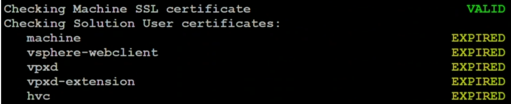

  • Output from running vCert Tool confirms Solution User certificates expired

This issue occurs because the vCenter Server Solution User certificates (machine, vsphere-webclient, vpxd, vpxd-extension, and hvc) have expired. These internal certificates are required for vCenter services to authenticate with the Security Token Service (STS) to acquire SAML tokens.
To resolve the issue, renew the vCenter Server Solution User certificates using the vCert script with VMCA as the certificate authority. Follow the detailed steps outlined in the KB article: vCert - Scripted vCenter expired certificate replacement
