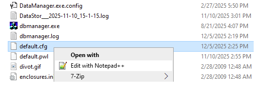

  5. Make a backup of 'default.cfg' file located in the eXpress share and save it in a different directory
  6. Open 'default.cfg' with a text editor (may need to run a text editor as administrator, then open the file)
  7. Scroll to the bottom of the .cfg file and find the section labeled '[PXEServers]'
  8. Remove unused servers by deleting the entry. Once desired entries are deleted, remove any blank lines left behind. Keep each PXE server entry on a separate line. Save and close the .cfg file
