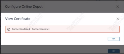

  • The Online Depot Configuration from VCF Operations UI fails with the following error while accepting the certificate:
    Connection failed : Connection reset
