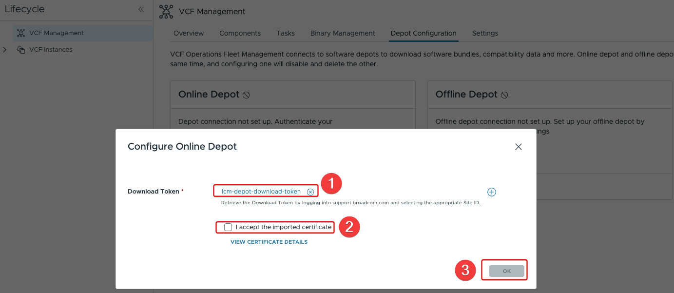

When configuring a Depot in VCF Fleet Management in an environment where a proxy server is in use, the following behaviors are observed:

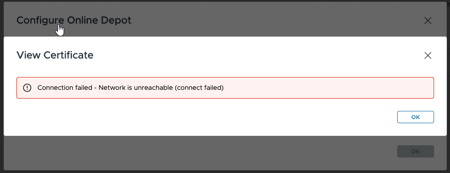

- Clicking “View Certificate Details” results in a validation error. " Connection failed - Network is unreachable (connect failed) "
- The error message persists in the user interface even after the depot is fully active.
- Despite the validation error, the depot is able to successfully connect, and product binary downloads complete without issues.

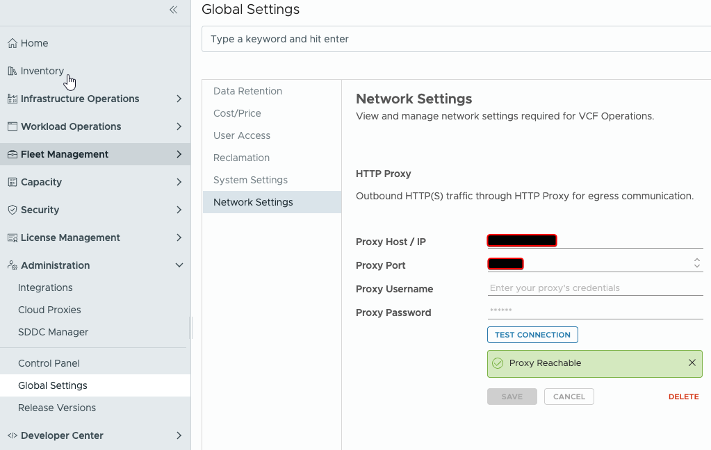

The issue is caused by the component responsible for retrieving certificate details (CertificateUtil) attempting to connect directly to the depot endpoint https://dl.broadcom.com without applying the configured system proxy settings. However, the actual file download service does correctly utilize the proxy configuration. This results in a "False Positive" scenario where the certificate validation fails due to the missing proxy route, but the functional task of downloading content succeeds.
