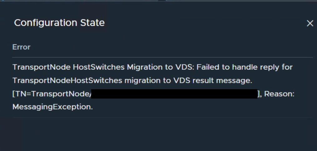

TransportNode HostSwitches Migration to VDS: Failed to handle reply for TransportNodeHostSwitches migration to VDS result message.
host_config_status: CONFIG_STATUS_FAILEDfailure_code: 8804failure_message: "TransportNode HostSwitches Migration to VDS: Failed to handle reply for TransportNodeHostSwitches migration to VDS result message. [TN=TransportNode/UUID], Reason: MessagingException."VMware NSX
This is a condition that may occur in a VMware NSX environment.
This issue occurs due to stale NVDS to VDS migration entries remaining in the management database (Corfu) from a previous migration attempt. After upgrading to NSX 4.x, these leftover parameters incorrectly trigger a host switch migration flag causing the realization process to fail as it attempts an unsupported migration step.
