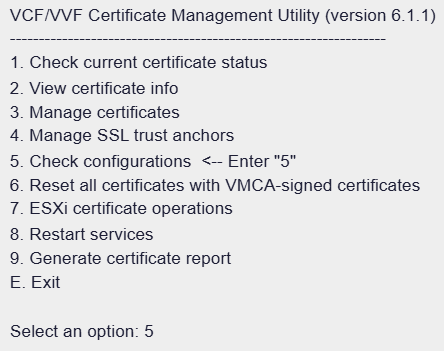

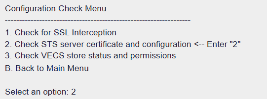

  3. Launch the updated vCert tool and navigate to Main Menu → Option 5 (Check configurations) → Option 2 (Check STS server config) to update the STS ConnectionStrings

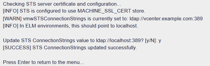

  4. When prompted to "Update STS ConnectionStrings value to ldap://localhost:389? [N]" enter "Y" to update the value

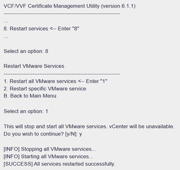

  5. Restart the services on all vCenter nodes, this can be done by using vCert Main Menu → Option 8 → Option 1 → Y or by running the command service-control --stop --all && service-control --start --all
