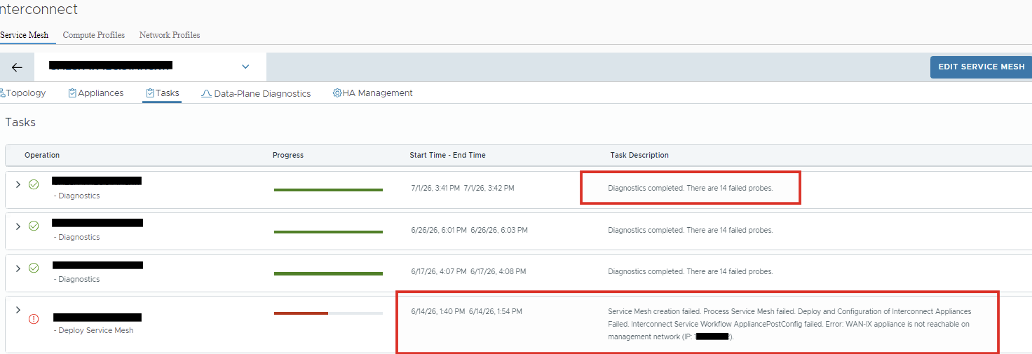

  • The following error message appears on screen:
    "Service Mesh creation failed. Process Service Mesh failed. Deploy and Configuration of interconnect Appliance Failed. Interconnect Service Workflow AppliancePostConfig failed. Error: NEW-IX appliance is not reachable on management network (IP: ##.##.##.##)"
  • Unable to ping the NEW-IX appliance from HCX Manager
  • TRACEROUTE commands to the NEW-IX appliance fail
  • The failure occurs specifically at the AppliancePostConfig stage
