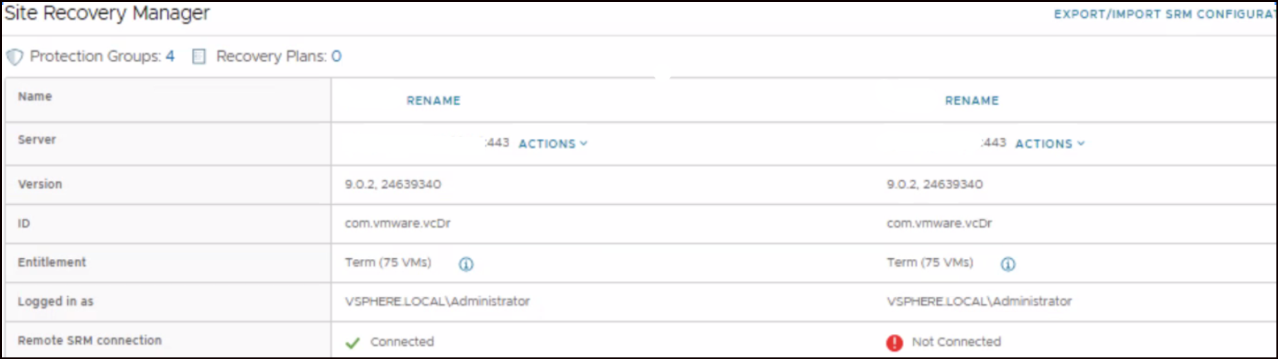

  • VMware Live Site Recovery (VLSR) site pairs are not communicating.
  • Attempting to log into the Live Site Recovery admin portal results in an "HTTP/1.1 503 Service Unavailable" error.
  • A server error message is displayed when attempting to retrieve site pairs: "A server error occurred, Check the server logs for more details."
  • The Site Recovery UI displays the VLR state as "Disconnected" or "Unknown" following appliance reconfiguration
  • Reconnection attempts to the site pair fail with the following error: "Unable to connect to VMware Live Site Recovery at https://<vCenter_FQDN>:443/drserver/vcdr/vmomi/sdk"

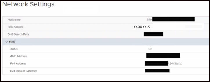

From VLR DR VAMI(5480) > Network Settings, Incorrect DNS Servers.

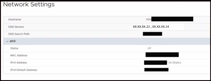

From VLR PROD VAMI(5480) > Network Settings, Valid DNS Servers.
