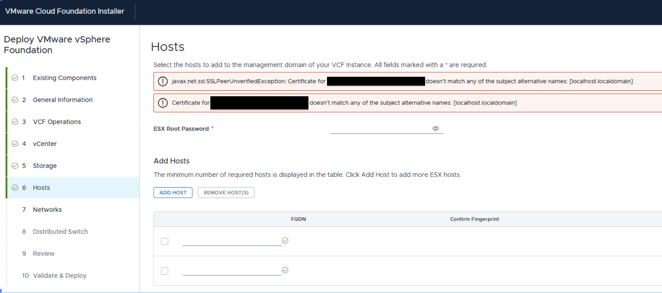

  • This article provides steps to address the issue encountered during VMware Cloud Foundation Installation while validating ESX hosts to be added to the management domain. The error message
    "javax.net.ssl.SSLPeerUnverifiedException: Certificate for <esx.example.com> doesn't match any of the subject alternative names: [localhost.localdomain]" and "Certificate for <esx.example.com> doesn't match any of the subject alternative names: [localhost.localdomain]"
    "javax.net.ssl.SSLPeerUnverifiedException: Certificate for <esx-short-name> doesn't match any of the subject alternative names: [esx.example.com]" and "Certificate for <esx.example.com> doesn't match any of the subject alternative names: [esx.example.com]"
  • A similar error message is seen in the VCF Installer UI.
