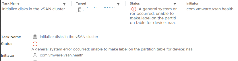

While adding a disk to the vSAN disk group, it may report an error as below.
A general system error occurred: unable to make label on the partition table for device: naa.5000########
On the vCenter UI, the error would show as below.
