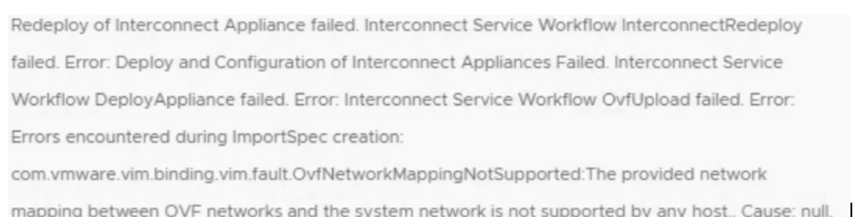

The failure of service mesh deployed with the following error displayed on HCX UI
Error messages in /var/log/app.log
Errors encountered during ImportSpec creation:
com.vmware.vim.binding.vim.fault.OvfNetowrkMappingNotSupported:The provided network mapping between OVF networks and the system network is not support by any host. Cause: null
VMware HCX 4.3.x
The appliance redeploy failed due to the required deployment specs (OVF networking) not being available to HCX manager.
This error indicates that the various configurations within the Service Mesh are out of sync.
Perform a Force Sync on the service mesh and its appliances to re-sync the configuration.
