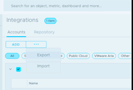

              (b) Export the integrations JSON from Aria Operations - see below screenshot.

  • Navigate to Administration -> Integrations.
  • Find the vCenter where the VCF license is applied, select the three vertical ellipses, and click on 'Delete'.
  • Ensure to keep the 'Delete related objects' unchecked to preserve historical data.
  • After deleting the account, re-add the vCenter adapter by adding back the credentials and hostname.
