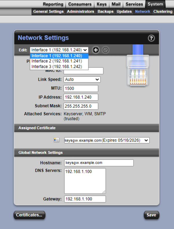

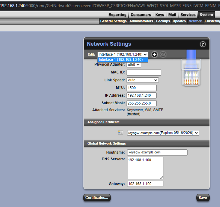

To view the Network Interfaces, go to System, Network on the PGP Encryption Server:
Notice in the screenshot above, we have only one interface.

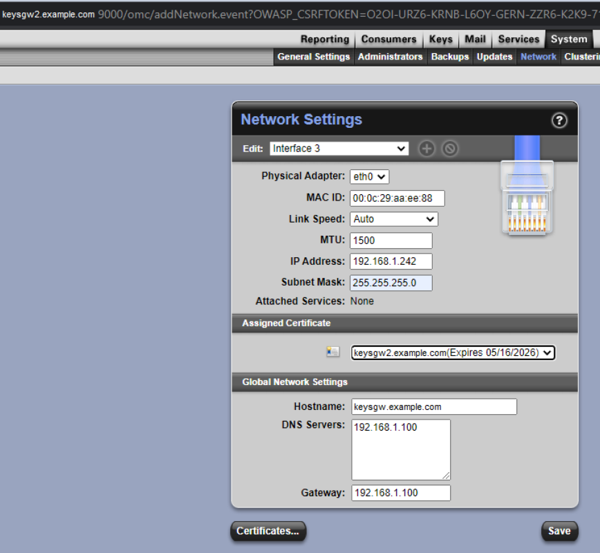

In the following screenshot, notice the IP Address (192.168.1.242), and hostname (keysgw2.example.com), as well as Hostname, and especially the "Assigned Certificate":
Warning: It's very important to create the certificate before creating the interface.
You will want to assign the certificate at the time of adding the interface.
In the above example, we are going to create "Interface 3", and notice the certificate is listed as "keysgw2.example.com".
Once you have all the fields entered, including the certificate, then click Save.  The network service will be restarted:
Notice in the message above, the network settings are saved, and will take some time to restart.
Also, instead of the Interface 3 hostname being listed, this screen will list the main interface for keysgw.example.com.
Once this has been done, the new interface will be listed and should now be available to assign to various tasks/services for the PGP Encryption Server.
