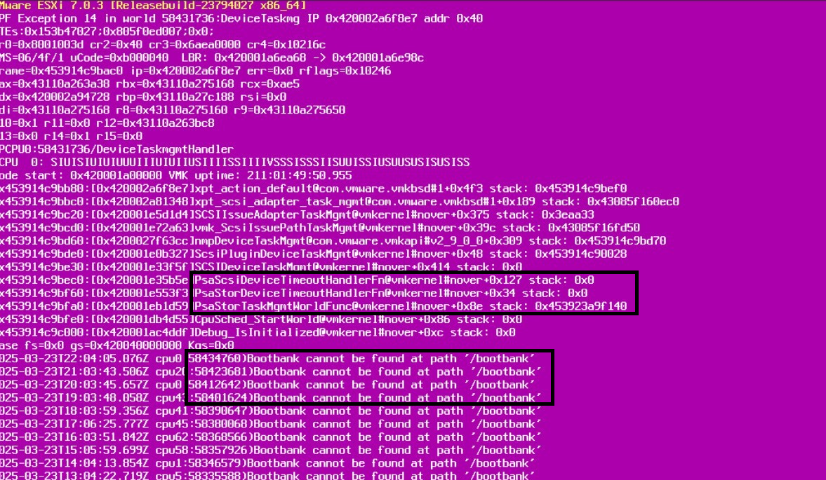

  • The Host runs into a PSOD and the stack trace points to the below errors,
    • PsaSCSIDeviceTimeout
    • PsaStorDeivceTimeout
    • Bootbank cannot be found at a path '/Bootbank'
      Below is a PSOD screenshot stack trace for reference

  • The stack trace shows "Bootbank cannot be found at path : /bootbank" indicating the VMkernel is unable to find the bootbank.
    Bootbank is a partition or area where the VMkernel and its essential components are stored.
    This partition contains the files necessary for ESXi to start and load the VMkernel, including drivers and other essential system components.
    The bootbank must be available and accessible for a normal function of ESXi Operating system.
  • The stack trace also indicates The VMkernel is issuing commands to nmpdevice where the ESXi is installed
