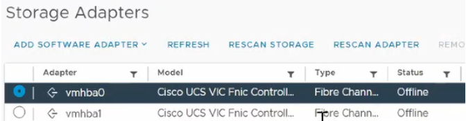

From CLI of host, the port state shows offline:

DriverVersion: #######
From hardware end the Fabric link status is Online.
Even after performing Fabric Login reset the HBA status remains offline.
VMware vSphere ESXi 7.x
VMware vSphere ESXi 8.x
