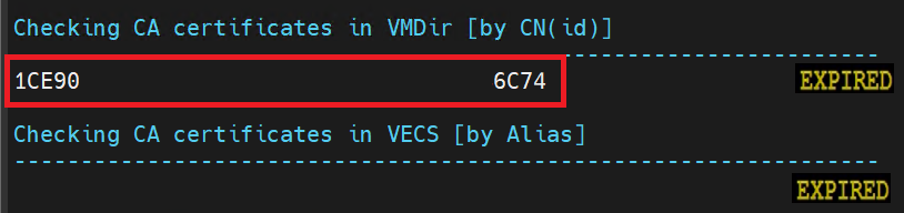

  2. Run vCert option 1.
  3. Take note of the expired CA certificate ID.

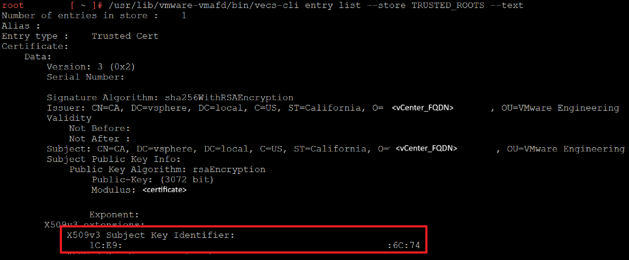

Verify an expired CA certificate is not in use
  1. Obtain the CA certificate Subject Key Identifier:
    1. Use vCert option 1:
    2. Obtain with command:
      /usr/lib/vmware-vmafd/bin/vecs-cli entry list --store TRUSTED_ROOTS --text

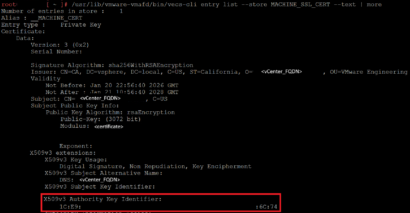

  2. Run the command for each certificate to verify if it is using the expired CA certificate.  The Authority Key Identifier will match the Subject Key Identifier of the CA certificate in use.
    /usr/lib/vmware-vmafd/bin/vecs-cli entry list --store MACHINE_SSL_CERT --text | more
    /usr/lib/vmware-vmafd/bin/vecs-cli entry list --store machine --text | more
    /usr/lib/vmware-vmafd/bin/vecs-cli entry list --store vpxd --text | more
    /usr/lib/vmware-vmafd/bin/vecs-cli entry list --store vpxd-extension --text | more
    /usr/lib/vmware-vmafd/bin/vecs-cli entry list --store vsphere-webclient --text | more
    /usr/lib/vmware-vmafd/bin/vecs-cli entry list --store SMS --text | more
    /usr/lib/vmware-vmafd/bin/vecs-cli entry list --store hvc --text | more
    /usr/lib/vmware-vmafd/bin/vecs-cli entry list --store data-encipherment --text | more
    /usr/lib/vmware-vmafd/bin/vecs-cli entry list --store wcp --text | more
