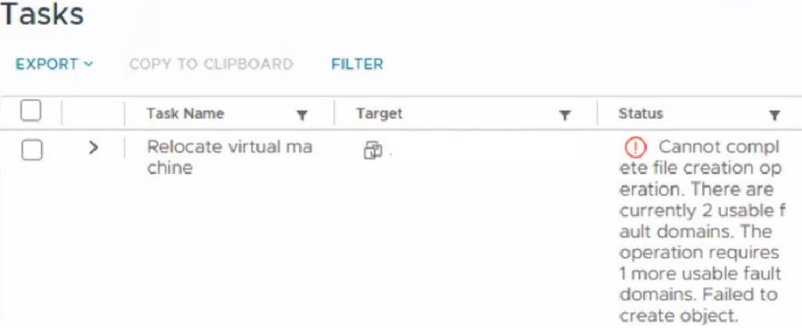

1. vMotion fails with error "There are currently 2 usable fault domains. The operation requires 1 more usable fault domains. Failed to create object"
Below messages are seen under vCenter UI > vSAN cluster > Host > Virtual machine>Tasks
