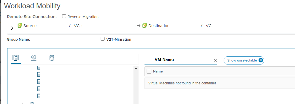

  • The inventory UI loads after selecting the source and destination sites.
  • When searching for a VM, it is not present, while other VMs are loading correctly.
    Virtual Machines not found in the container
  • The VMs can be seen from the vSphere inventory, outside out HCX.
