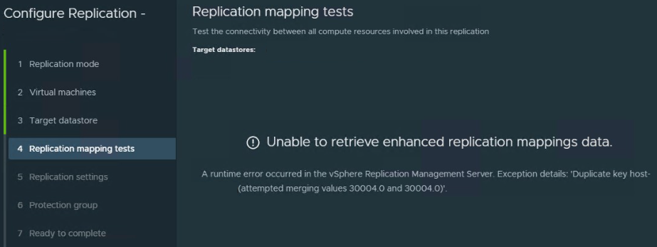

  • Unable to Add VMs to Enhanced Replications.
Error: "Unable to retrieve enhanced replication mappings data"
"A Runtime error occurred in the vSphere Replication Management Server. Exception deails: 'Duplicate key host-#### (attempted merging values 30004.0 and 30004.0)'.

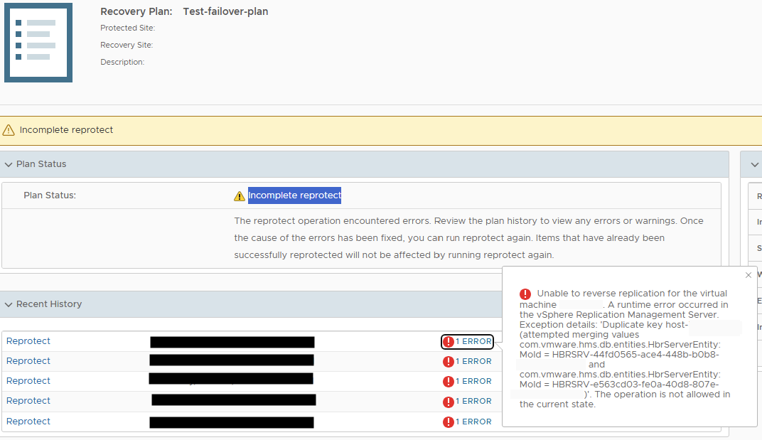

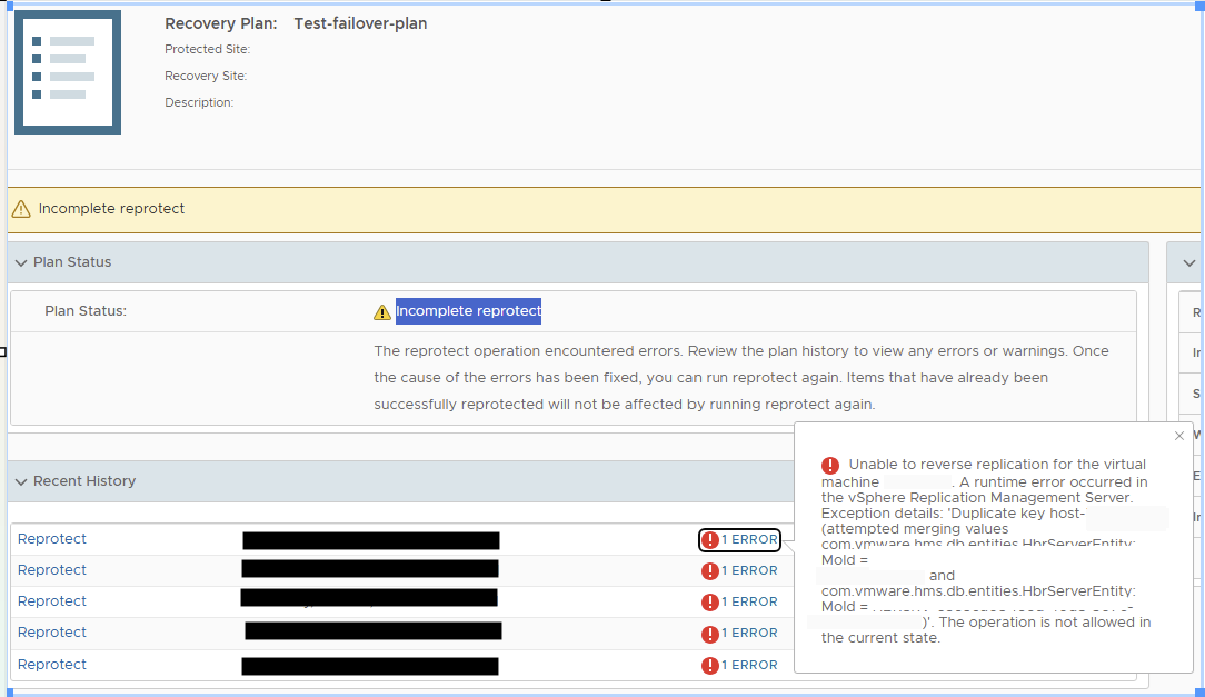

  • Unable to reprotect recovered VMs. Reprotect operations fail with the following error:
"Unable to reverse replication for the virtual machine 'vm_name'. A runtime error occurred in the vSphere Replication Management Server. Exception details: 'Duplicate key host-## (attempted merging values com.vmware.hms.db.entities.HbrServerEntity: MoId = HBRSRV-#### ace4-448b-b0b8-######### and com.vmware.hms.db.entities.HbrServerEntity: MoId = HBRSRV-e####3-fe0a-###-####-#########)'. The operation is not allowed in the current state."

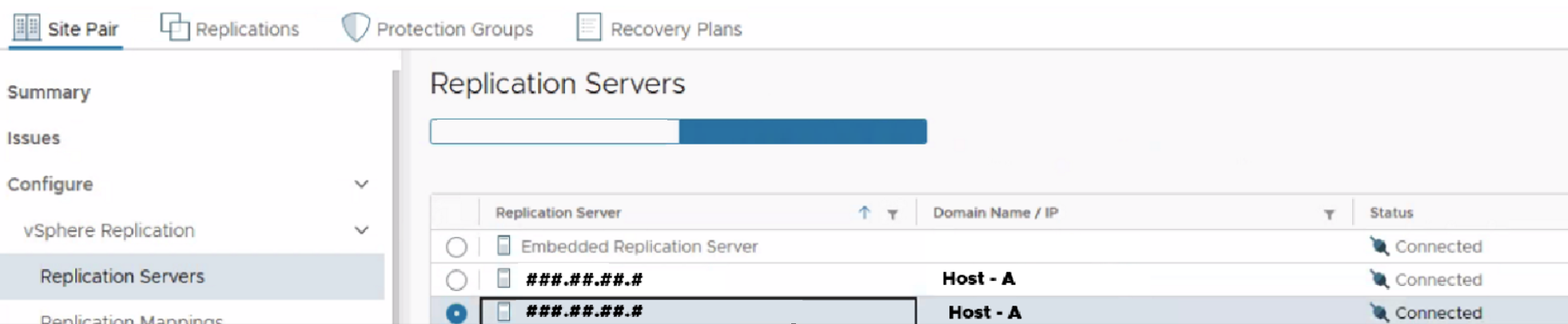

  • Duplicate host entries appear under replication servers sections:
  • HMS service may crash while attempting to pair sites which may have got disconnected
  • Validation of hms.log confirms that the workflow fails because multiple vSphere Replication Server entries exist for the same ESXi host, resulting in a duplicate key condition during the processing of the particular operation.

####-##-## ##:##:##.### ERROR response.filter.I18nActivationResponseFilter [tcweb-2] (..hms.fault.ExceptionToFaultConverter) {operationID=40b41651-d19d-49d7-9652-0bc9aca88478-reprotect:mx:gn:m4-HMS-1393195} [] | Fault conversion needed. Method 'getReverseReplicationInfo' cannot throw
com.vmware.vim.binding.vim.fault.InvalidState: Duplicate key host-## (attempted merging values com.vmware.hms.db.entities.HbrServerEntity: MoId = HBRSRV-####-ace4-4###-###-######## and com.vmware.hms.db.entities.HbrServerEntity: MoId = HBRSRV-e563cd03-fe0a-40d8-807e-########)
