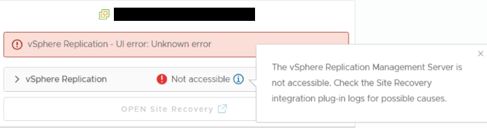

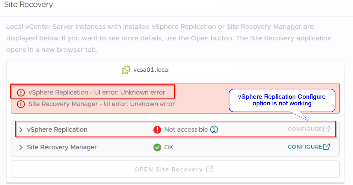

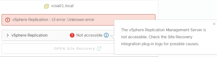

  • vSphere Replication is not manageable from the vSphere Client SRM plugin page and fails with the error 'vSphere Replication - UI error: Unknown error'.
  • Clicking on the "i" symbol shows the following information: "The vSphere Replication Management Server is not accessible. Check the Site Recovery integration plug-in logs for possible causes.":

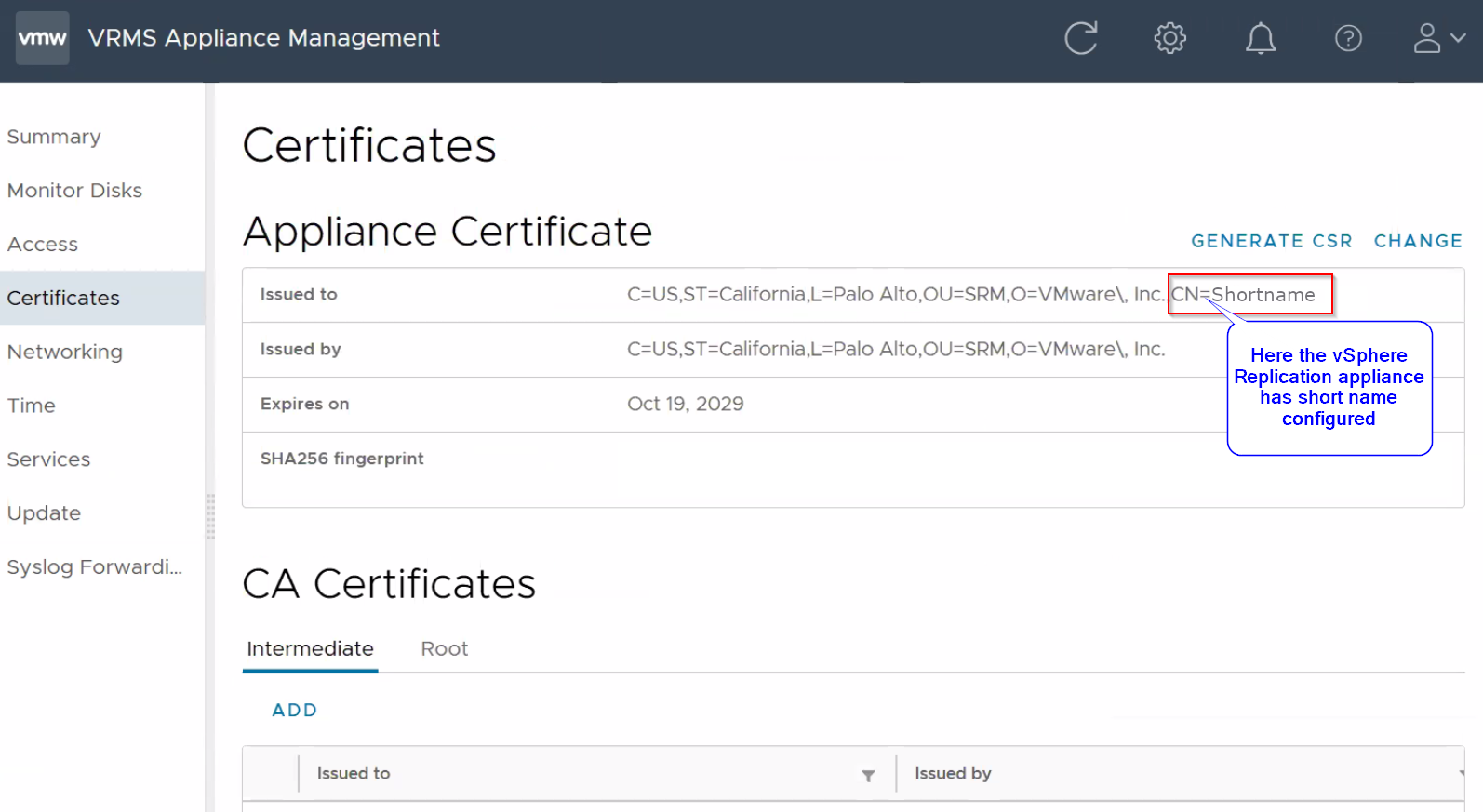

  • The vSphere Replication appliance VAMI page indicates that in the certificate CN=localhost or IP address or Shortname or anything other than actual hostname.
  • vSphere Replication 8.x
  • vSphere Replication 9.x
  • vSphere Replication appliance certificate is configured with a short name/IP address instead of FQDN which is configured in the networking hostname:

Login to the vSphere Replication appliance VAMI page and update the certificate from short name to vSphere replication appliance FQDN
  1. Log in to the vSphere Replication Appliance Management Interface as admin.
  2. Click on the Certificate option click on Change and validate whether the vSphere replication appliance hostname is correctly updated in FQDN format and complete the name change process flow and this will end the current vSphere replication appliance session.
  3. Login back to the vSphere replication appliance and reconfigure the vSphere replication appliance using FQDN/Hostname.
  4. Once the vSphere appliance reconfigures is completed, the vSphere Replication appliance should be manageable from the SRM UI page.
