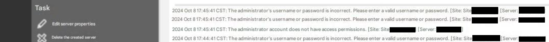

Frequent errors observed under Admin tab on console : The administrator's username or password is incorrect

In Endpoint Protection manager (SEPM) > Admin tab, following error appears:
The administrator's username or password is incorrect. Please enter a valid user name or password

Unexpected error due to Disabled SEPM admin account
Delete the notifications created by the disabled admin account and then delete this admin account.
Note : If admin is deleted without clearing the notifications created by the disabled admin account, those will get assigned to existing default admin account.
