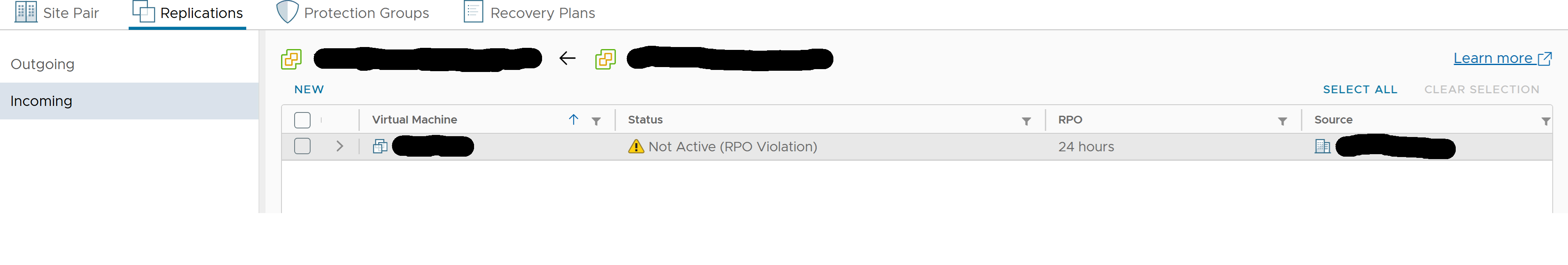

Not Active" state in the DR UI:Troubleshooting network and TCP/UDP port connectivity issues on ESXi

Retrieve VM running replication state: The VM is configured for replication. Current replication state: Group: GID-0789481a-8004-3604-xxxx-yyyy(generation=123456789) Group State: lwd delta (instanceId=19065dd0-b292-407f-xxxx-yyyy) DiskID RDID-dd42c93d-22e3-3149-xxxx-yyyyState: inactive

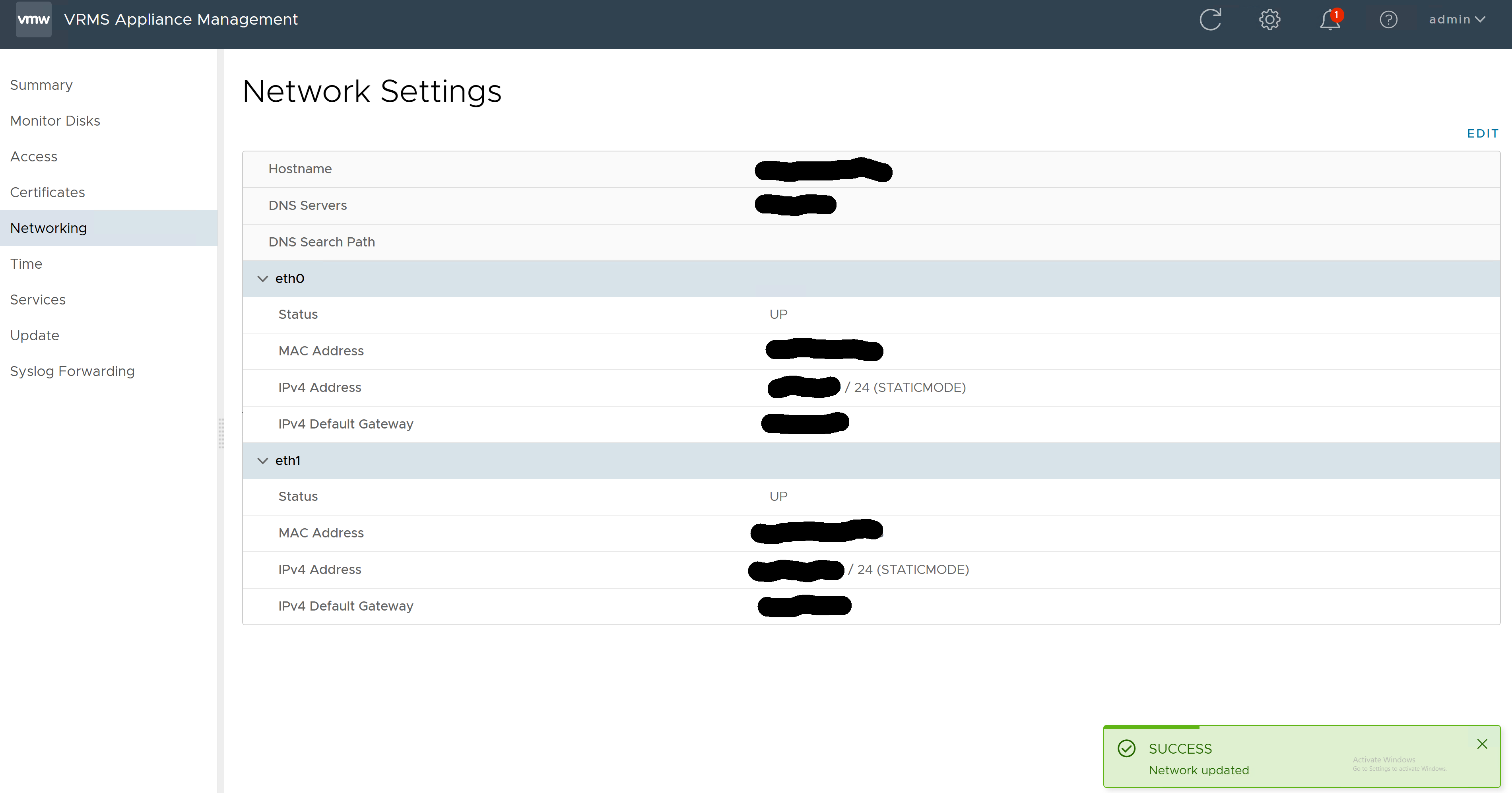

dr-config" service has not been able to successfully change/update the IP in the HMS DBdr-config" is the service responsible for updating configuration details from the VAMI UI to the HMS DB hbr-agent, which manages the replication for the VMs in the ESXi host, then uses these configuration parameters to replicate the datahbr_filter.destination" IP is different from the expected IP of the target replication server for replication and NFC:VAMI) and confirm if the target replication IP gets updatedIf the symptoms and issue matches, and the above two steps do not resolve the issue, please contact Broadcom Support to investigate the issue
