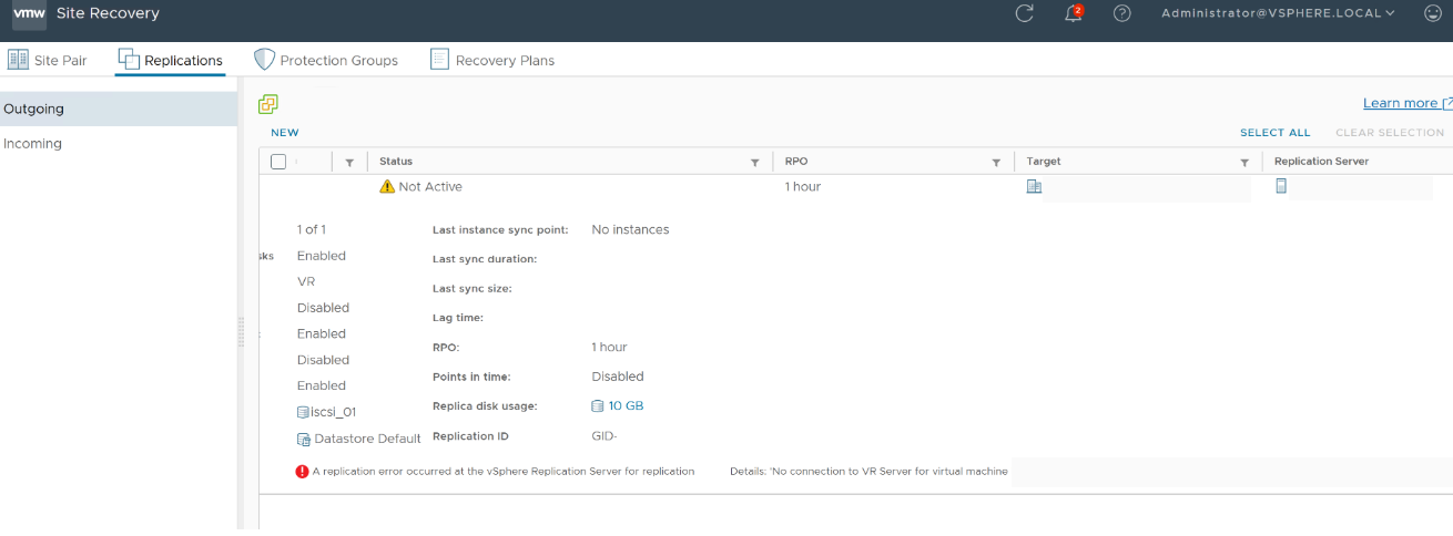

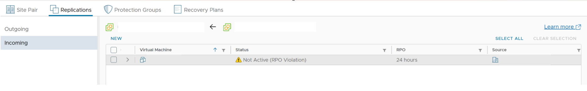

  • Post configuring network isolation for vSphere Replication data and NFC, VMs throw RPO violations errors in the DR UI
  • The VMs go to a "Not Active" state in the DR UI:

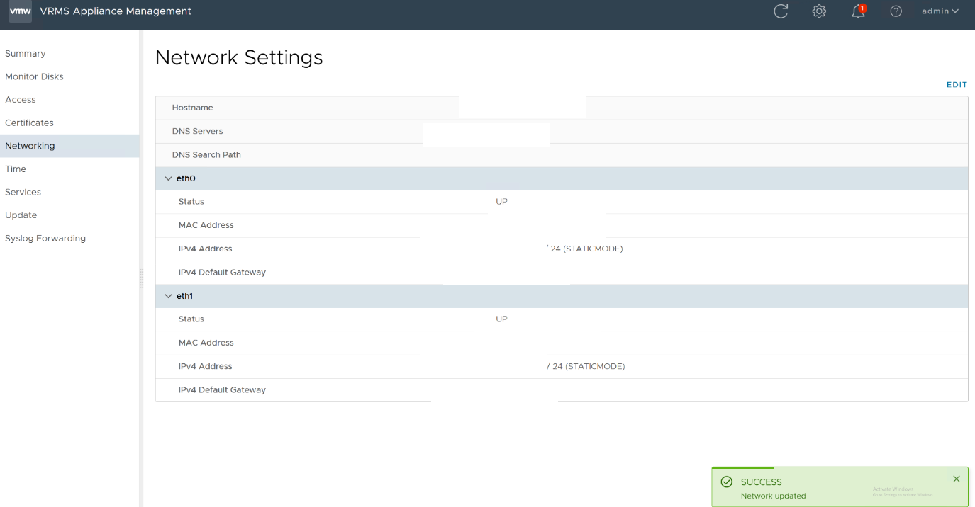

  • The network isolation task completes successfully in the VAMI UI:
  • vSphere Replication Isolation Network is configured as per recommendations

  • You may receive error "Failed to connect to VR server" while configuring replication in the DR UI:

  • If the IP in the HMS DB has not been updated when the network configuration is changed, it causes the replication for the VM to run into RPO violations, thereby causing them to go "Inactive"
