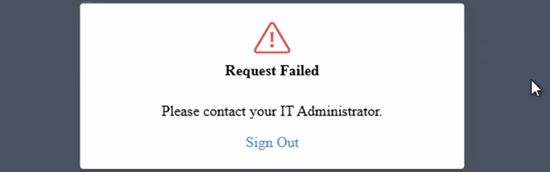

  • Signing into Workspace ONE with a VIDM user or other Broadcom products using VIDM authentication results in an error similar to the screenshot below:

  • Attempting to login to VMware Identity Manager request may fail with "Request Failed Please contact your IT Administrator"
