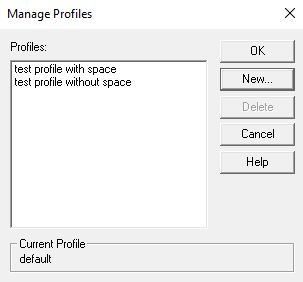

Profiles are in use in the DX UIM Infrastructure Manager (IM). When attempting to delete one of these profiles in the Manage Profiles menu, it appears to delete the profile, but when opening the menu again or listing the profiles, it remains.
  • Infrastructure Manager 4.10, 20.4.x, 23.4.x
Profiles may be created with a trailing space.  These spaces are not visible in the Manage Profiles menu:
Profiles with this space are not able to be deleted by IM.  When you 'View Profiles' you can also see that the profile has not been deleted.
