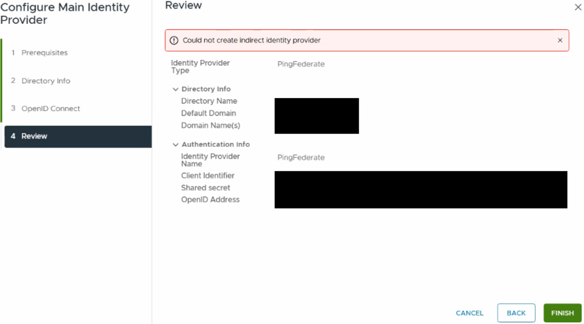

  • After removing the PingFederate (or other) IdP (changed back to embedded SSO), attempted to re-add PingFederate and received error on “Review” (finish) page of “Could not create indirect identity provider”.
  • Configuring External Identity Provider on vCenter Server fails with error "already exists for tenant <tenant_name>".
  • vSphere Client will show below error message:
    Could not create indirect identity provider: Identity provider with ID ##-##-##-##-## and name <Identity Provider Type Name> already exists for tenant <tenant name>
    Failed to delete usergroup directory with ID ##-##-##-##-## for tenant customer on host <vCenter_FQDN>
  • This KB can be followed to to clean-up stale Identity Provider Configuration such as "Okta", "Microsoft Entra ID", "PingFederate", etc. on vCenter Server.
